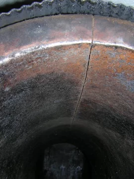

sounds like an 8 inch appliance necked down to a 6 inch thimble if he has a lined flue should not need to slip line , but should stay with a 6 inch flue'd appliance which should be ok in a ,2K sq ft house, a 2 to 2.5 CF sized unit would be what I would shop for, as long as the home holds heat reasonably well big enough to hold overnight , small enough to keep the paint from peeling in the stove room.
