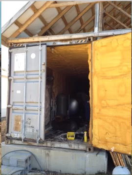

I helped a neighbor with this. A Hardy OWF inside with a 1000 gallon dairy tank for storage, entire inside and underneath was foamed.
I saw an EvoWorld pellet boiler being built into a containers with all the piping and buffer tank, last year at their factory in NY.
