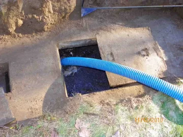

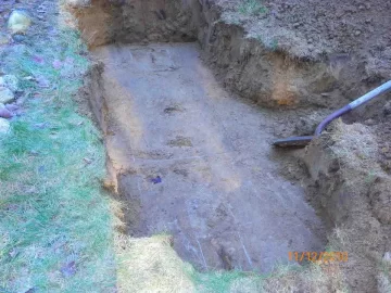

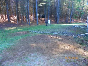

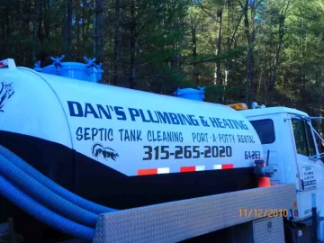

Took the day off and dug the septic and distribution box up then had the septic pumped and the distribution box was clean. Time spent digging the filling it back in 2:20.
We have it pumped every 3-4 years if it needs it or not.

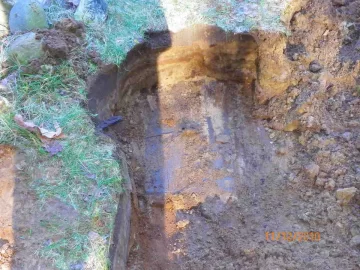

Pic 4 is that thing full?
Had some room but it was up there.

daveswoodhauler our septic if working right will only get as high has the pipe in the baffle leaving the tank, in the picture the fluid was not to the top of the baffle which was good to see.
