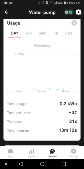

Cool. Depending on manufacturer and model, a 20 gallon tank would typically have a drawdown around 6 gallons at 30 - 50 PSI. So when your pump kicks in, it should probably take at least 30 seconds to fill the tank, based on a typical < 10 GPM pump setup. You can easily see this by running water until the pump kicks on, then shutting off the water and watching the tank fill. It will take longer (by ~2 GPM) if you leave a single faucet running while it fills.
If I recall, you were seeing the well kick on/off in 10 second intervals before, so this would be a good way to ensure that issue is resolved.
Yep, 30-45 seconds to fill, I didn't time it exactly but it has made a world of difference.
This was yesterday's usage:
[Hearth.com] Sense Energy Monitor
