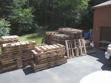

Feedstock for my stoves:
  • [Hearth.com] scrap lumber
