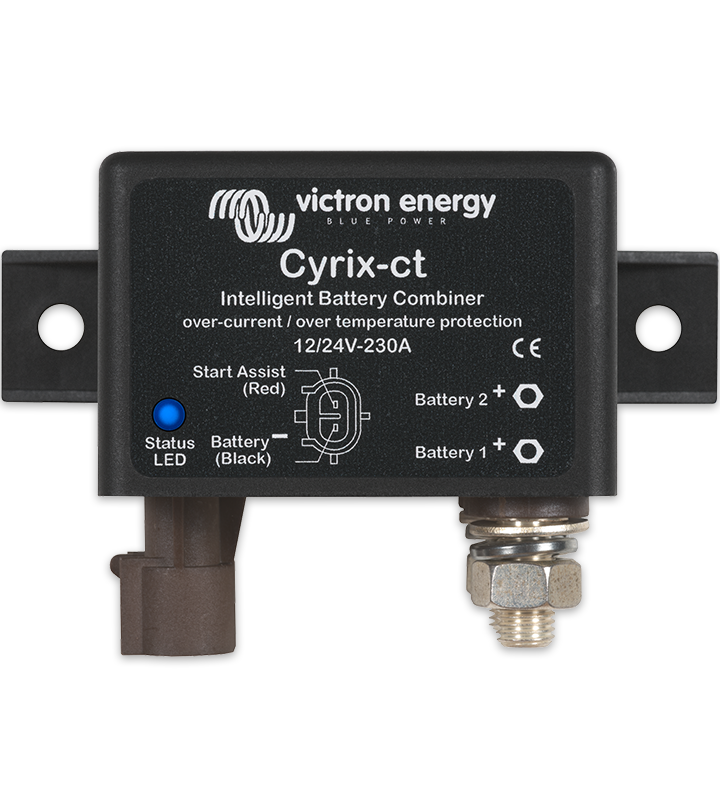

There are devices available that address this problem by isolating each battery from the others when charging is not occurring. They basically connect the batteries in parallel when the voltage at the source battery reaches a certain threshold, and then disconnect the batteries when the voltage drops below another threshold value.
Use of one or more of these may be simpler than trying to balance batteries permanently connected in parallel, especially when the size and age of the batteries differ.
Cheaper versions are available on Ebay.
