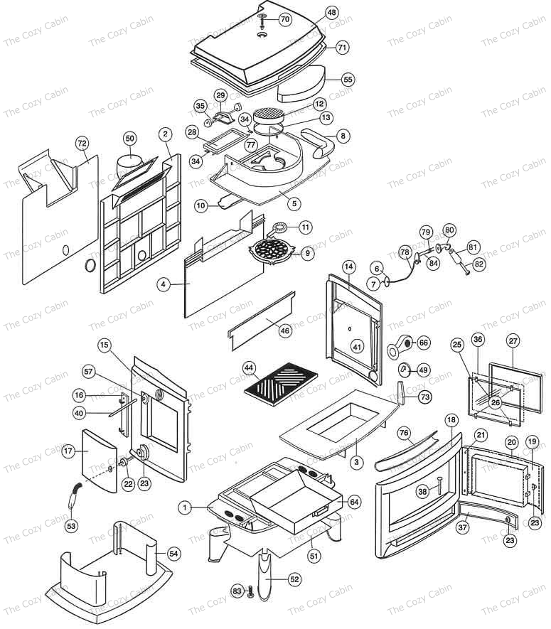

Are there still any Seneca owners here? Trying to piggyback on this thread for some tech support. I recently bought a house with a Seneca. It works but the temperature gauge/prong slides right out, not sure if it’s doing anything. Also there are 2 cracks on a plate that fits in the rear of the stove (I don’t believe it is the back plate, there is a stove wall behind the cracked plate). I have looked at the instructions and the parts list/diagram and I cannot figure out if this curved plate was installed by the previous owner, or it was a flat plate that warped and curved inward toward the stove, or if VC sold this model with a few different options? Any advice from Seneca owners?

Thanks! My intuition is that the plate warped, bulged inward into the stove, and then cracked vertically along the curve. The plate doesn't have any markings/depth changes/casting lines like the back plate you linked, it is smooth (aside from the cracks and some burnt on debris), which is what leads me to believe that perhaps the previous owner had replaced the original backplate with a plain sheet of steel (the previous homeowner was a DIYer and had a welding setup).
Assuming in either case, that a new back plate will fix my problem, the current plate is held by to metal flanges/sleeves that extend from the side plates. Do I need to remove the top of the stove to uninstall/reinstall the new plate?
Well, I slid the warped plate out and and turns out that the other side does have the markings similar to the plate in the link. I believe it will work as a replacement. Thanks so much!
