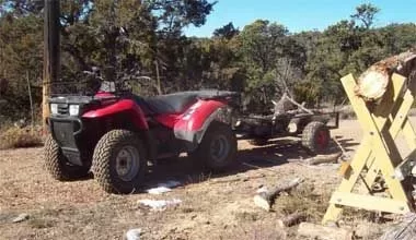

Thanks- I currently use a guide and bastard file, not a tapered rat tailed file. Here's a pic. And yes I'm aware of filing in one direction, what I was saying in fileing side to side that one side I seemed to get more bite was when I turn the saw around to file the other cutters it seems that I get a better leverage angle with my left hand and therefore get a sharper edge on the one side than the other..................

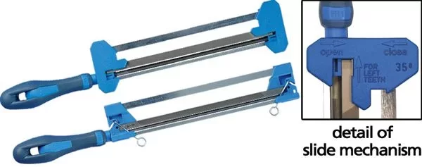

The Pferd is the easiest and best hand sharpener I've ever tried and still use. A touch-up filing after each tank of gas keeps the chain in great condition.
