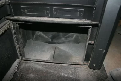

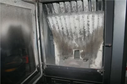

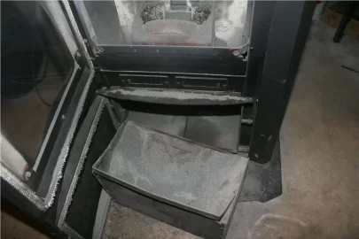

I have the 25IP. Going into my 2nd year with it. Overall I'm happy with it. Here's what I worked out as a sustainable maintenance routine for it:
  • During the season the stove is running full time in hi/lo mode on a simple thermostat
  • Every night I stir up the burn pot without shutting down.
    • Takes about 30 seconds (don't go too long or you can kill the fire)
    • I have a bent and flattened pipe I use for this
  • Every week I shut down and do a cleaning.
    • Dump and scrape burn pot
    • Brush the ash from all around the box, removing the baffles.
    • Empty the ash pan
    • Vac the inside out
  • Monthly cleaning is basically the weekly cleaning plus removing the access plates and cleaning out the exchanger.
  • Clean the flue about every other month.
I found that worked well for me. Obviously filling the hopper as needed. The ash pan is big enough to hold a weeks worth of ash, but it does pile up and you have to redistribute it to the center of the pan. Not a big deal as it's part of the weekly cleaning.
Not sure if that would satisfy your requirements, and one of the bottom feeders or a multifuel would probably reduce the daily maintenance further, but I don't find that procedure onerous and it did work well for an extended period.
