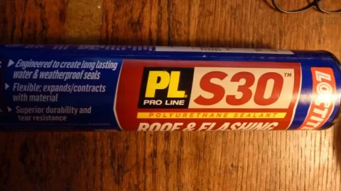

Polyurethane...make sure it's fresh.
[Hearth.com] Roof Leak
