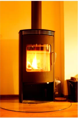

Here is a photo, taken from another site that depicts the glass hearth over wood.
Its a beautiful installation.
