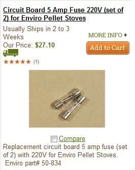

PS: 70 cents worth of fuses for $27? A strain relief for $32!!! This is beyond the defense dept's budget.

I'll sell ya a couple of fuses for $19 to save you some money. Shipping included.
So are internet prices like a few magnitude greater than dealer store prices?

Some parts are proprietary,can only get them from mfg.Now you see why on this forum a lot of info about "aftermarket"blowers,ignitors,etc.A lot of sellers and dealers sell at what the market is going for,period.Not enough competition.Your cast iron,if metal thick,can be bead blasted and painted.Sales can depend on what the seller wants to do,I have seen the same integra part vary from $110 to $179 from different suppliers,yet the part only comes from one supplier.Shipping/handling another story.Do not know what the stove is worth.Bob

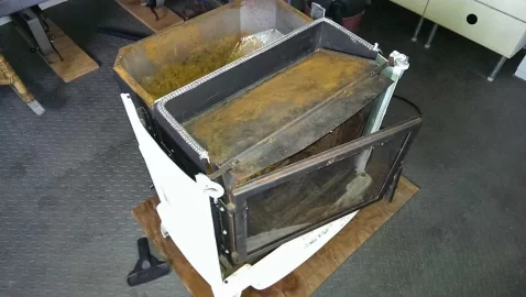

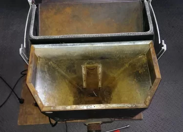

The white enameled cast iron is in near perfect condition with nary a nick or chip in it. Just the steel and interior cast plates are rusted. Here is a stripped down view from a few minutes ago. I have to get some 3" exhaust pipe to test the stove with after I further clean and paint the hopper and auger. If it can run well and cycle I will attack the firebox itself.

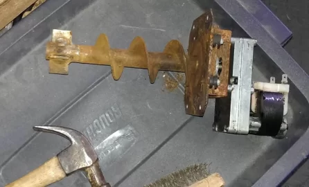

Powered up the auger and lubed the bearing. It all seems to work fine.
If you have it that far I would carefully pull the gearbox apart and freshen the grease too.

It looks similar to your avatar. The main issue with this stove is neglect. I think it failed with a corroded and plugged vacuum barb and the owner gave up and put it on the porch where it sat for a year, poorly covered and internally rusting.The hopper had several inches of water that I bailed out when I got it. All systems seem alive, but it needs a lot of love for the inner steel parts. Crying shame really.

Not leak so much as dries up, or sometimes not enough applied at the factory.
