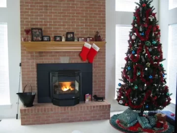

Pic of the Country attached! Nice little stove
