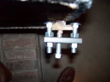

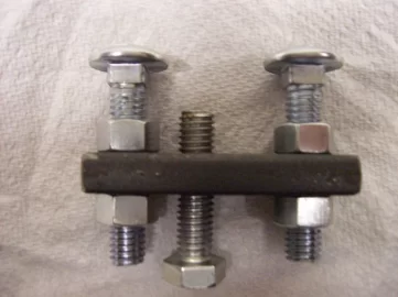

Thanks,Craig. Will try, great illustration.I made a small puller that would couple to the cam and pull it off. Very simple, two carriage bolts, one hex head bolt a few nuts and a small bar 5/16" thick with a tapped hole and (2) thru holes. After using this puller I discovered you can tap all (3) holes and use one nut on the carriage bolts as a jamb nut to hold the carriage bolt in place and from turning. If your cam is anything like mine on my Liberty this puller will work like a charm...........
I did edit this with some pictures and the PDF.......
