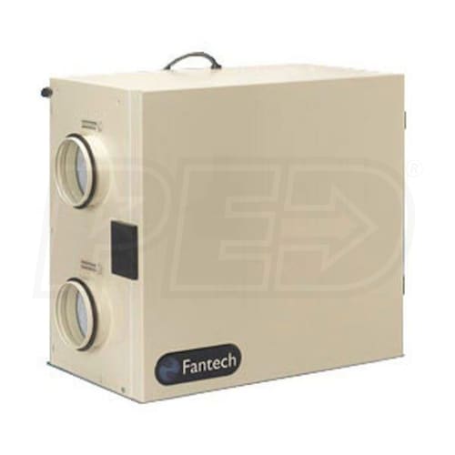

Starting to think the way to go is ventilate the space between the vapor barrier and the plywood with an "energy recovery ventilator" (ERV), such as:
... avoiding the pitfalls of sucking excss humidity into that space in the summer, or increasing heating loads in the winter.
I may be misinformed, but in my understanding an ERV does not prevent (much) the humidity from coming in?
(It does help with the winter heating load issue.)
From the docs (at that link):
Compact ERV with easy mount wall bracket. Brings a continuous supply of fresh air into a home while exhausting an
equal amount of contaminated air. The enthalpic core at the
center of the unit transfers heat and moisture from the
incoming air to the outgoing air. The air brought into the living area is cooled and the humidity is reduced for maximum
comfort. Reduces the load on a home’s air conditioner to
save on cooling costs.
It'll do something but the water transfer is not nearly as efficient as the heat transfer, afak. But maybe my knowledge is old and technology has progressed.
Looks like has some dehumidification. I’m guessing some Peltier type cooler???? It’s has a defrost cycle. So it has to have a drain line right? Can you adjust the in and out cfm independently?
