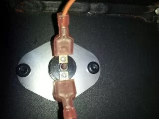

I've replaced the auger motor and I am still getting the same result. I was reading in the manual that came with the stove and it says that the high limit temp switch might need to be reset. There appears the be a small button on the back of the switch but I can not push on it.
You can see in the image the red button protruding from the middle of the switch. Do I try and do anything with that? Can anyone tell me what the startup process is when I press the power button? What starts first, second , third? Any help would be appreciated.
