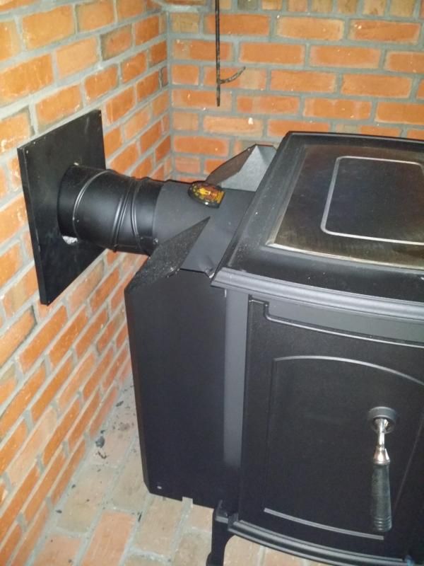

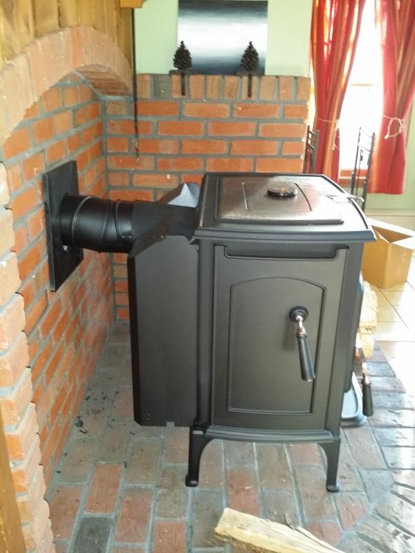

Yes, the newer stoves are much more sensitive to wet wood, depending on the species of wood you have it may need more time. To rule it out go buy a couple of the bundles of wood from the supermarket they sell for fireplaces and try a load with that, that wood is kiln dried, if it works ok with that wood you have your answer.Thanks for the info so far. Could there be anything else? I had the old Jotul hooked up to the same flue and it worked just fine. I'm guessing these type of stoves are sensitive to how dry the wood is....or is not....

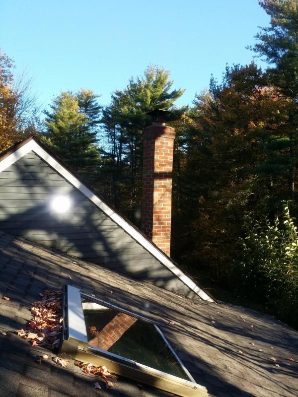

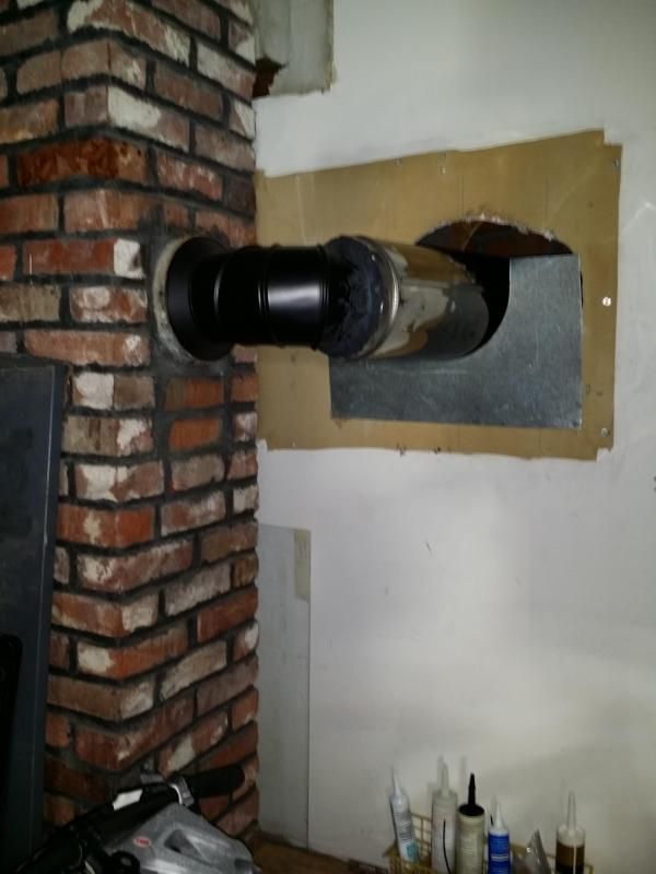

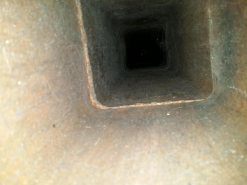

It is a6 inch flue 4 foot horizontal pipe which takes a 90-degree turn into over 12 ft chimney
