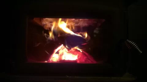

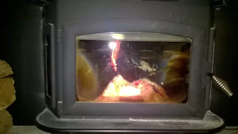

That being said, I have found something that works fairly well in my stove in terms of burning down ash & lighting up a reload. What I have been experimenting with once the coals have burned down some is an "ash log." I scoop the ash to the center in a pile a little smaller than the splits I am putting in, I stack the splits with small air gaps around the "ash log." I will use 3 or 4 splits and "balance the wood" placed on top so they fall to the center as they burn up.
Results so far: 1) The wood ignites faster and gets to the point where I can dial the air back faster. It creates a flame tunnel or vortex of some kind which ignites the wood even to the back of the stove. 2) The burn tubes kick in faster and we get quite the flame show as we dial it back. 3) The "ash log" glows red to orange and burns down the ash to a much finer powder [the wife noticed that as she was cleaning out the ash one day]. 4) We get another day or two of burning in before having to scoop the ash out. 5) There are a couple of cold zones in my stove that build up creosote. Since doing this, the stove is/has been burning the creosote off. Most of the build up is gone. 6) Heat...I seem to be getting more heat with less wood, which is always good.

Some pictures...not the best though but you can see the basic idea. the first is shortly after the reload and the second is after dialing the air back. Still learning the new interwebbery device & the camera on it.
