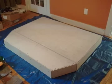

I have built two raised hearths. I luv them! They both have an overhang for rope light install and also I can get close for cleaning without the old Toe Jams!
I put an Electric 220 Volt 900 Watt kickSpace heater with wall thermostat in my raised hearth. So I could keep my feet warm when the stove was down for cleaning! Then I made an overhang with a recessed 1/2" inch slot and installed rope light!! It cost me $600 with the tiled back and mantle! I wonder how much if I paid someone else!!! LOL See pics below!
P.S. Also made it to hold 9 - 12" x 12" tiles so no tile cutting LOL

Built a big box that could support my 700 lb. stove.
Raised hearth pad
Following the manufacturers guidelines I used 1/2" cement board on top of 3/4" plywood and then tiled it with 1/4" slate tiles.
