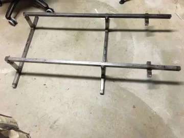

I made my own from square tubing which I welded together. Certainly a lot easier, especially when having the chimney swept.
Having the stove raised helps getting to the fan underneath.
  • [Hearth.com] Rails worth it? - accentra 52i
