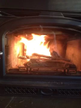

Ok, it's time for pics. All of the wood burned is 15%-20% ash that was checked before adding to the stove. Cleaned with rutland's conditioner before starting fire.
Here is startup with a few small splits and a handful of pine 2x4 kindling
[Hearth.com] Quadrafire Voyageur Grand dirty glass all the time
Here is 20 min later with the door closed and primary and startup air fully open
Here is 40 min later after everything burned up and went to coal, so I reloaded with some larger stuff and snapped a pic
30 min later, primary air still all the way open
2hrs later after adding a few fresh splits. Primary air still all the way open

That glass looks a lot like mine when I first got the stove.

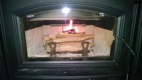

I think your top down is packed too tight. There is virtually no change after 20 mins. You want it to burn hot and fast to heat the pipe. Attached is my top down from this morning after 15 minutes. 6 pieces of oak, but they're criss-crossed.

If your wood is good I would think you've got a draft problem. In an earlier post you mention being able to turn your air down to 1/4 and get a decent burn time but in your last post with the pics you mention on the last one that your air has been wide open for over two hours and that turning it right down will 'snuff out' a hot fire.
I'm no expert and unfamiliar with your burner but on my stove if I left the air wide open for two hours I'd be seriously over firing things, and the glass for certain would be spotless and the least of the worries.
** Is it possible that I'm throwing too big of splits in the fire? Once it's going good, I'll take the largest splits I can find and stuff as many as I can inside. they're usually half of a 8"-10" log
These are big splits - wood stoves burn differently than fireplaces, and it is possible that these big pieces are not really 18-20% m.c. after one year CSS (even cut "dead standing"). I don't trust most cheap moisture meters - it is possible that you don't have the m.c. that you think you do.
Does the fire burn aggressively once a reload is established? None of those pics show any real flame - not with full air anyway. Is the baffle/blanket positioned properly?
