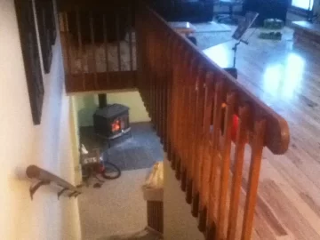

House layout is very important. While our house is well-insulated, the stove is located in the lower level where warm air moves freely up to the next level.
  • [Hearth.com] Pushing a stove hard during cold weather justify a second stove?
Now the next decision is should I buy a small stove to put upstairs, or should I get a much better cat stove for downstairs and move my existing stove to the upstairs.

No one sleeps downstairs but it is our family room is down there and we spend most of our time down there. So I would probably still use the downstairs stove and just run it on low. Wife and I discussed just using the gas furnace but even she much prefers the wood heat over the furnace. So will likely be looking for a small stove to run upstairs. Won't buy anything until spring or summer so in can get a better deal on one, hopefully a store model or display on sale.
