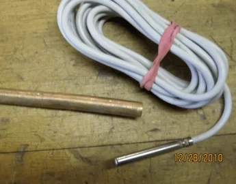

That is a 1000 ohm sensor, very common on European controls including most of the solar controllers. The red or black jacketed ones have a better outer jacket for high temperature and outdoor applications, better UV protection jacket also. For inside use, the grey jacketed ones are fine, maybe less $$.
The end is a 6mm diameter and fits just right inside 3/8 OD copper tubing if you need to build a well to attach it, use a a dab of thermal paste.
