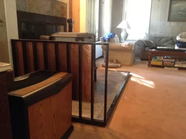

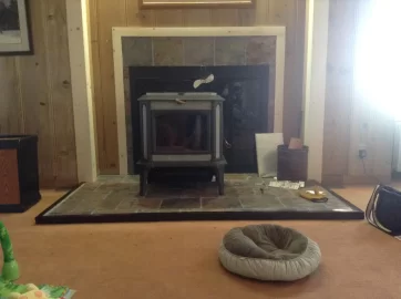

Now that the piano is gone, are you going to remove the copper shield? I would want to look at that stove, and feel the heat as much as possible.
That is an attractive stove.
The humidifier is right on the other side of the shield and a computer desk so I was going to leave the copper up, I like the rustic look.

The piano is a good 15 feet from the stove and I will be keeping the room humidified. The computer that now resides where the piano was I hope it melts pos hp.
How far is it from your hearth to the rug? I'd be more concerned about the rug than the humidifier.
Yeah it would look much better and more natural without the cage. Is that soapstone on the stove? Nice look.
The stove is soapstone walls cast iron frame.

Beautiful stove, and the secondaries from the holes in the top of the firebox are memorizing! Enjoy...
My guess is with kids, they might touch it once, then they will become disinterested in doing that again. With that said, I have burned myself on the Progress more than any other stove for some reason. Still the best stove I have ever owned, (takes some counterintuitive getting used to) just installed this stove in it's 2nd location in East Dorset Vt, and banged an outside air intake through the heatolator steel in back of hearth then through some natural stone. But got the outside pipe above snow level. You will enjoy this stove.

Looking better, I'd keep going and remove the remaining fence, and I know it's a little bit of a re-work, but reset the stove more into the fireplace and not it out in the room so much, my $.02.
Why do you think it should be more into the fireplace? Farther out the better right? I am barely clearing the side alcove walls. The last bit of fence might be coming down.
No more fence and no more smell coming of the stove. The wife thinks it's not going when it goes black in cat mode for this shoulder weather.
