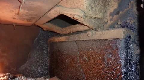

How is the exhaust area going to be creod up if the cat is burning the smoke when the stove is smoldering? I see a little creo in the flue exit area when I have the top flue plate off to go after the cat, but just flaky dry stuff. I figured that was from bringing the stove up to temp with the bypass open on a somewhat cool stove and the cat not processing the smoke.
I reloaded just now and snapped this pic. A bit of creo in there but not too bad I don't think. Mainly in the back corners. I only run flame in the box intermittently, and then only maybe an hour before I go to all-cat mode.

Exactly.....best to burn the PH hot and keep the creosote to a minimum....
That's probably the way to burn these stoves the cleanest. If you get a buildup of creo in the box and then have a lot of the flame in the box when firing up a fresh load extra hot, the creo in the box burns off and smokes out the 'hood..so much for the myth of the "low-emissions cat stove." ;hm But burning with more air throughout the burn is sending more heat up the flue and efficiency is going to drop I would think. You'll have to burn more wood for the same amount of heat so I guess it's six of one, half dozen of the other.

fespo, I've used the PH with the screen in and the screen out. IT IS best to take it out. The screen seems to cause more air flow problems than the cat. Regarding the cat, vacuum it out monthly and you should be good. The pic of your cat was pretty bad. I've never had my cat anywhere near that dirty. Glad that you are figuring out your stove. You will really enjoy it!
