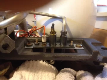

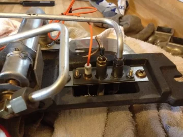

I started to install the conversion kit regulator cap went on ,NG Injector went on Now for the NG Pilot Orifice I
cant budge the nut on the Pilot Inlet. I have used a brake line wrench so not to screw up the nut .I cranked on it pretty hard (didn't want to push TOO hard in fear of breaking something else. I have removed the burner assembly and have been using KANO SILI KROIL (penetrating solvent with silicone) for the past 24 hours to try to help but nothing doing.
Model Number 2600
Serial Number 8036
The stove was originally NG and the retailer he bought it from converted to LP (tag on back)
I have included a pic of the fitting
