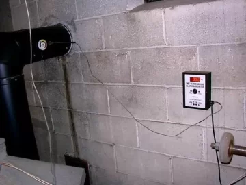

I don't see any reason why it would make a difference, single or double wall.
I have had a probe on the basement Fisher ( single wall) for years.
So Wes, are you saying both of your thermometers (electronic and mechanical) are reading the same temperatures on that single walled pipe? Or is the radiant heat from that single wall throwing off the readings on that mechanical probe?

Actually , no the mechanical thermo is a magnetic mount meant for single wall pipe,
it reads fairly close to the IR gun, and is about half the temp of the internal thermocouple probe.
Hope this makes sense.
Makes sense to me.
Is that creosote that has dripped down the wall?

OK, my mistake, I thought the mechanical thermo was also a probe type. I was curious how significant the difference would be.
