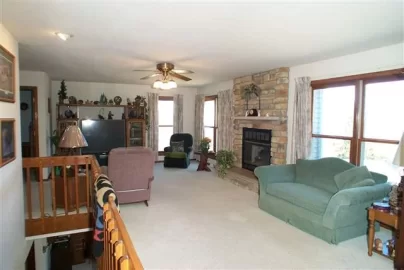

Looking at the photos, does anyone see any big issues jumping out which will make installation of the Fireview problematic? What I'm
thinking is that we'll need to remove the firebox, chimney, elevated hearth and stone facing and open that area up. The living room flooring
is going to be changed out to hardwood as soon as we get in, so this will be the time to do it if we're going to put in a stove and stove hearth upstairs.

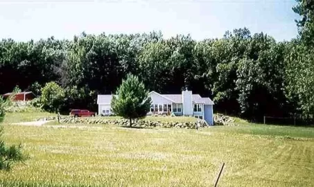

What other issues do I need to be looking at? You can see the chase on the outside view. And, yes, Dixie. these are the same pics that I posted before. I want to make sure I'm making the best choices with what I've got to work with. Am I wrong in thinking that if one of those big prefab fireplace chimneys fit in the chase, I shouldn't have any problems with clearances with the appropriate 2100 degree Class A in the chase, correct? I have a lot of confidence in my friend building this to code, but does anyone see any red flags?
