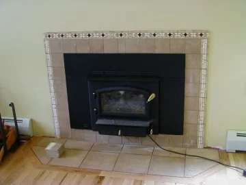

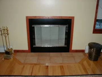

That truly does seem like the most bang for the buck. I think we have the same Heatilator ZC fireplaces (Accelerator 36R). I went with the Quadrafire 2700i. It is smaller, but puts out a fair amount of supplemental heat. It doesn't protrude much on the hearth, so that didn't require modification. There was a Quadrafire dealer near me too. Attached are before and after pics.
I thought of that big quad fireplace before I got the insert. As the others said, I think it uses the same flue system. For me, I think it might have just about fit in length and width wise, but the flue wouldn't have lined up with the fireplace outlet, and the chimney chase would have to have modified (if I recall). That fireplace would look pretty good in that stone chimney, if it would fit.

Brotherbart, it was not that tough to install, the flu lined up just barely, but it lined up. I would not have been able to install it if it did not have the feature of being able to connect the flu collar from the inside of the insert. The quality is there. The welds look good, no gaps, size is true and square, nice solid latch, thick flu collar, good solid hinges. The unit extends 5 inches from the outside of the fireplace opening to the front of the insert, and 9 inches if you count the ash shelf. I was lucky and only had to add one row of tile onto the hearth to keep my clearances.
The blower is variable and is nice and quiet unless cranked on full. It says it can handle logs up to 20 inches, and that is 20 inches both ways. So you can lay them in back to front or left to right. No trouble getting a secondary burn, and that was with a rookie at the controls (me). The blower throws heat accross my family room with no trouble at all. I have not stoked it for an all night burn yet. I don't know how much it will reduce my heat bill as well, but it's gonna be a heck of allot better than it was.
I did not buy the trim surround as they wanted $285 (canadian) for it. I am about done with a fabricated one out of some scrap 3/16" thick metal I had laying around. Just a few more welds, a little grinding, then sandblast and paint. Only problem now is the wife wants me to change out the tile for split stone, so the cosmetic part of the project will last awhile.
I live in Michigan, and my closest dealer was in Canada. With the exchange rate and the waiving of taxes by Canada for larger purchases made in Canada by US citizens, I got a really good deal. The dealer I dealt with deserves a plug as well, they treated me well, and made the purchase really easy. Threw in a few frebies also. I did talk to a stateside dealer, but, it was farther away and I got some bad vibes from him (wanted all $$ up front, plus a shipping charge even though I was gonna pick it up, and he wanted more for it in US dollars than I was paying in Canadian before the exchange rate difference!)
There are better looking units, but the fit was perfect for my application. That was the major reason for the purchase. That and the size of the unit. Sorry if I sound like a commercial, but just wanted to pass the info on. I looked long and hard to find the largest unit I could to fit my fireplace. KD
