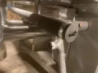

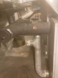

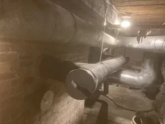

How bad was the buildup in the pipe?

Draft? Nah, don't need that.. horizontal flue is perfectly fine... I even insulated it...
Sadly I have a horizontal flue on my wood furnace. No joke. It was done by a licensed plumbing and heating guy not long before I bought the house. I am only half way through the season and I pulled 6 gallons of creosote out of the stove pipe and 3 gallons out of the liner.
This is in the style of Central Pennsylvania, no?

View attachment 290805 View attachment 290806 View attachment 290807

It is never very hot. The air intake is locked in the fully open position. Normally this is only done during a power outage. There is a servo that opens and closes the air intake in response to the wood thermostat. Mine gets stuck and does not function (part of the Grade F furnace install). Anyway, it is fully open and the temperatures never run away. In fact I often have to open the door to the ash pan to prevent it from burning too cold. Even then it only gets in the moderate range (300 to 500 degrees... never above 600, and that would be only momentarily).
One poster pointed out that insulation would help prevent the cooling of the smoke and buildup to some degree. This is true... however I also have an overall draft problem at the furnace. It doesn't draw enough. It will smoke into the basement.
I want to get rid of the thing, and probably get a boiler for backup heat. However, I need to use it at least this season. I wonder if there is any in line fan that could help move the exhaust through this 7" horizontal stove pipe at get it at least to the vertical chimney liner.
Also, I wonder what you guys think of this wood-oil combo furnace in general. Napoleon HMF-150. I will mostly be using wood stoves on first floor. If I arrange different backup heat (boiler or even electric).... is there any good use for this old furnace, or is it scrap? I could potentially move the furnace close to the thimble and improve the draft situation. I am tired of the dust and noise, but I am wondering about taking out most of the ductwork and just having it blow into the basement to keep the basement at 50 degrees or so, when it gets really cold.
