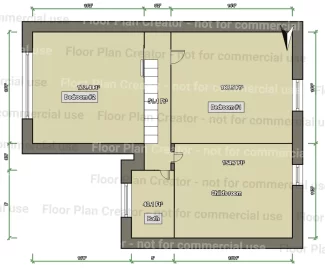

Thanks so much for all your input! I've drawn the floor plan so you can see what I'm dealing with. If any of the dimensions are strange its because I was guessing!

At this point I was thinking a couple of things, though it depends on what my wife thinks. I was thinking of putting an 8000 BTU unit in the bathroom with the hope that I can keep the child's room cold enough. Then I was thinking of possibly putting another 8000 BTU unit in bedroom #1 with the hopes that I can keep the other bedroom cool a well.
What are your thoughts?

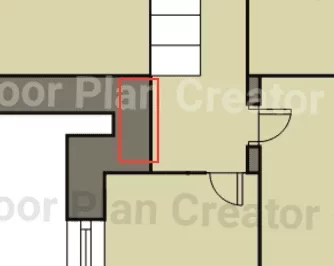

OK, I see your dilemma now. It's going to be a challenge due to the orientation of the rooms relative to the roof slope. Just speculating, but I am wondering if an AC opening could be framed in here?
[Hearth.com] Portable A/C vs. Ductless
If not, I would get a quote for a single head mini-split AC unit that has the indoor head unit in the hallway at that location.
An AC in bedroom 1 will help some, especially if the doors are open in both, but given that the other room is already getting hotter, probably not very satisfactory.
I'd expect adding a vent directly between them would help a bit more, but at the cost of some acoustic privacy. There are ways to mitigate this, though. One configuration is placing the vent high in the cooler room and low in warmer room, with air going up and down the wall cavity. Baffles in the cavity help reduce sound even more. Also, some transfer grills have built in baffles and sound-deadening materials.
The best way to link the rooms thermally would probably be use two jump ducts, with a fan in one (maybe even on a thermostat switch) to establish good circulation.

The single unit minisplit in the hall is another good idea for a step up from a window unit in room 1. It would probably be the middle ground cost-wise, but might do pretty well at keeping the whole upstairs cool (again, if doors are kept open most of the time). A heat pump model would also earn back some of its cost on a lower heating bill.
