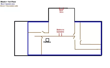

My house is a 2 story with approximately 3500 square feet. Of this, the lower level is about 2000 sq ft and was built in the late 1800's. We have removed exterior wall sheeting and added insulation, but there is very little under the house due to the amount of crawl space. The upstairs is about 1500 sq ft that we built on about 10 yrs ago. The upstairs walls all have R-19 and use 2x6 framing. Insulation up there isn't an issue as it is above average. The downstairs area is drafty when the stove is going because of the inability to get heat to the other side of the house. I am attaching a drawing of the house so you can further understand.
