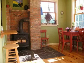

It might be a little late for this, but in the picture section of the same Tumbleweed house you're getting, there is an interior picture with a Jotul F3. It looks like an actual lived in house, not just a model. Maybe you could find out how it's working for that person.
