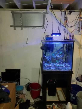

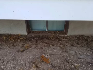

So I want to move my Little Buck Stove to my basement. Is there any way I can vent this out on the outside wall? The tank and all seen in the pics are going.

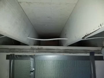

What's behind the duct tape area?

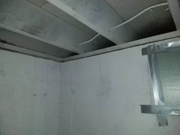

So yes there is a Chinney and flue that extends to the basement, but right now there is a gas water heater venting into it. I guess I can drop a liner down but it was a tight squeeze, I probably can only get a 6 inch liner down and I have the 8 inch adapter and liner on it now, not sure if I can reduce down.

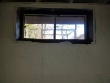

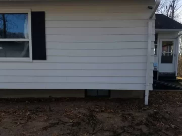

There is a window just like in the picture here. The wall and floor are concrete 6ft wall up to the window. Then a 2ft overhang to go up the side of the house, and then the roof had about 2ft overhang. As far as venting looking for any suggestions as I haven't bought anything yet, I want to see if it's possible.

Initially I'd say take out the window and lay a 9" terracotta crock in the center of the opening that sits 1" through the wall on both sides and brick in the rest of the window. Dig out about 18" down outside and install a window well so you have access room to the class-a pipe and install the chimney and roof flashing . Inside you'll need a heat shield above the class-a and you'll have to use close clearance/double wall stovepipe down to the stove. Depending on the rating of the pipe you'll need 6-12" above the pipe.

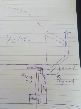

So the crock is basically for protection and holding the pipe in place? How about piping out of the well/window area turn up at a 45 degree angle till i get past the roof line then go straight up? I added a picture of what I believe you are saying.

Bottom has to be a T with cleanout and then properly bracketed to the wall going up.. That is way to much angle and would not work. If your overhang is that big then you'll need to go through the soffit and roof.
The bottom of the straight section going along the house needs the T correct? Once through the window the house over hangs about 2 feet, then up the side of the house and then the roof extends out about 2 feet.

OUTSIDE the window, T - horizontal opening facing house, bottom gets a T-cap, top gets first vertical section of pipe. Class-A needs to be at least 2" from structure. Then you need a piece of pipe to go through the crock into the room at least 4 inches or whatever mfg. instructions require.

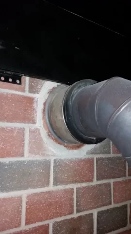

You don't need a crock . Class A runs into the house thru the wall thimble - minimum 6" ...
You're right. You could do a half-assed job and just shove it through the glass.
Follow my instructions and you'll have a properly installed class-a and it will have a nice finished look.

No, but in this case, as the OP presented it, to get a nice finished surface a crock would be the way to go. Not just laying the class-a on the sill and then bricking it in. In this particular instance a wall thimble is not needed as it's all masonry. There is no framed wall to go through and I didn't suggest framing the window in. However, if you did go that route then yes, you would need a wall thimble.

Just the way I do it. It gives a nicer finished look and if you had to pull the class-a for some reason all you'd have to do is pull it through and stuff a stainless T-cap cover in the hole.

Ha !!! You run the class A thru a wall thimble - there's your finished you . Find me any install directions on class A where it shows it running thru a crock .

It really has nothing to do with clearances, it's for appearance. The reason I do it is because you can't chisel a perfectly round hole in cement or block to put the class-a through (at least I can't) and cement or mortar doesn't bond to stainless steel. I cut the hole, slide in the terracotta as a sleeve and then slide the class-a through. The mortar bonds to the terracotta and finishes nicely and then the very thin gap around the class-a is sealed with a fireblock sealant or silicone.
