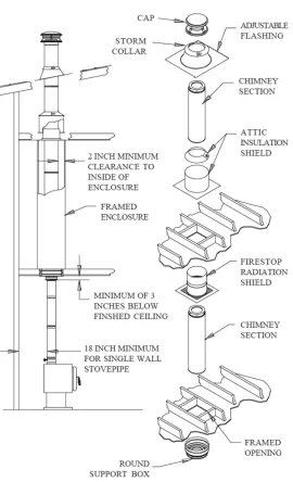

For sure the best solution is to have it 6" all the way. If the chimney pipe is old then maybe this is a good time to change it. This is a two story flue system installation diagram. If your installation is 1 story then ignore the 2nd floor chase and chimney section.
Thanks BeGreen! My application is a 2 story high great room. It's about 12' ceiling height where stove pipe will penetrate roof. So a smaller diameter pipe will have better draft? If so, is it important to maintain that smaller diameter once it penetrates roof?
The Napoleon likes a good strong draft and may require 6" all the way. Still, with 12 ft of double-wall, 6" stove pipe running inside the draft may be ok unless the chimney outside is only 3 ft. Do you know how much chimney height there is outside?

class A is insulated chimney pipe, in begreens diagram everything from the stove to the ceiling would be double wall and everything from the ceiling up would be class A.
