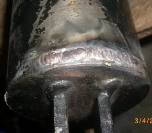

I got the cylinder back today. $50 for the weld job. The machinist said the pin hole was only about 1/4 long but he welded over 2 1/2 inches around it.

  • [Hearth.com] Pin hole leak in cylinder. Now what.
Looks like it was rubbing on the I-beam. Any way you can prevent that from continuing to happen?
Hi,
No the piston was not rubbing on the I beam.
While he said he was going to pull the piston befor welding it, when I got there to pick it up, I asked him if he did. He said there was no real reason since it was 4 inches from the weld zone. But you are correct. He should have done that. Now, of course, I have to put the whole thing back together to see if the seals are melted and then, if they are trash the cylinder and buy a new one. Doohhh!

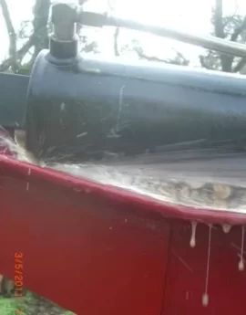

Good grief, that looks bad. I hope you are going for a new cylinder this time.
And what's with that hydraulic fluid? The pics look like it has entrained air or something.
Yup. New cylinder time. Neighbors are kicking in $250. Don't know what to say about the fluid. Since the cylinder was empty when I started, the air could be from the priming process. What a PITA. I can say this about hydraulic fluid, it makes a great skin softener.

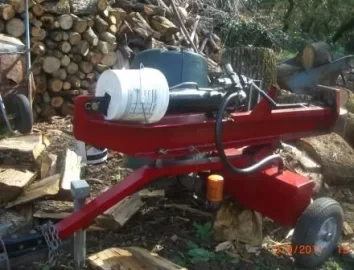

I'd just wait and do your splitting later or source the piston elsewhere if you need to work now. Why keep pushing your luck?
The arborists keep making drops and I have to clear out space for new ones. I've had 4 drops this week alone. If I wait till I get the new cylinder (who knows how long that will be) they might start to pass me by as being "full".
Point well taken though. Better safe that sorry. I appreciate your advise.
Well, I've put about 10 hours on the welded cylinder and split about 3 cords of arborist dump: oak, pine, and magnolia. Five dumps in all. So far no leaks. The new cylinder is comming in on Saturday.
