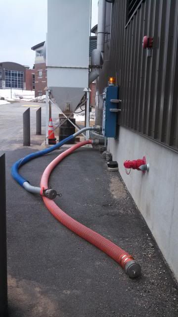

Moving pellets pneumatically is perfered actually. Here's our unloading system and silo at work.
520 ton silo, holds about 430 tons before the truck gets backed up
Unloading hoses for the trucks. Orange is 11psi air supply from our blower, the blue sheilded stainless steel hose is for blowing the pellets into the silo.

Is the orange hose providing a suction to the silo?
No, we blow about 10-11 psi of air to the truck in the orange hose. They charge the truck up with the pressure and then the rest blows through a line on the bottom of the truck and to the silos through the blue hose. The trucker then opens a valve on the bottom of the truck to allow pellets to drop in the travelling air stream to the silo. The air and pellets go up 40+ ft to the silo and dumps the pellets. The air vents out that tall square, white which automatically cleans itself with pulses of air backwards through 1 section of filter bags at a time. Dust falls out to the bottom and we empty it into a barrel when we're done with the load.
Interesting. So the truck itself does not use any compressed air to unload the pellets, it uses the 10-11psi from your compressor?
Is there a vacuum supplied to the filter assembly to help collect the dust or is it just fed by the compressed air from blowing the pellets in?
