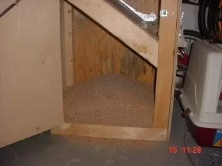

This is a picture after sifting one ton of natures heat its more than a drywall bucket full.
too much or about right?

I want one!! Post details please! What are you using for the grating??
ITS basically a rectangler box with a hole cut out on top,wire mesh is gutter covering i bought at home depot and cut to fit.
also used a joist hanger for the spout and put it a little higher than a drywall bucket then a door for clean out.not difficult at all.
The framing is not an issue, I just wasn't sure what you were using for the sieve.
Thanks!

This is a picture after sifting one ton of natures heat its more than a drywall bucket full....too much or about right?
Seems like a LOT of fines. A good quality pellet should have about 1/4 - 1/3 cup of fines per bag MAX. If you multiplied that by 50 bags, that would give you 12 - 17 cups.....looks like you have more than that, but maybe it's just the pic.

I have been sifting for about a half ton. AM actually using two buckets one a five gallon and inside I have a 3 gallon with holes drilled thoughout the bottom. THe 3 gallon fits perfectly on the lip of the 5 so there is no spillage when spinning the pale.
The fines are at about 1/4 of the first 5 gallon which would be 1/2 bucket for a ton.
I like your sifter and would love to see more pics from different angles.
