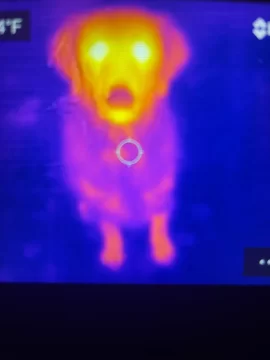

When I moved into my house I got spots of condensation on my ceiling and little patches of mildew that formed on spots on the walls. I’d forgotten about that. They’ve been ironed out over the years. Going around the house with a FLIR camera can be fun.
BTW, a dog’s nose really is the coldest thing they can press into you.
