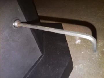

In this case, the easy slide out ash pan has two standard 5/16-18 Thread with an allen wrench well in the top of the bolt!!
What were they thinking! If burglars break into your house, the wood pellet ash is really safe unless they carry a 5/16" Allen wrench!

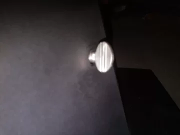

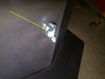

So I went to the hardware store for a knurl know like they have for computer cases. (Unfortunately they are too small) The hardware did have something I knew of but just could not picture it. A thumb screw!! Yes all different sizes but there was a problem, the 5/16"-18 Thread only came in the one inch long size not the 1/2 inch long size that I needed. However better to be too long than too short! So then I noticed the back workshop where they fix screens and cut shades. I asked the kid if he could just cut the bolt. He asked the lumber desk worker and the guy said he did not think so!! I said it is not stainless steel and asked if he had a hacksaw and bench vise. He said yes and proceeded to make the cut. Then after I saw a little struggle, I said you must pull the saw back 2 or 3 times to start the cut and then you it should work! It worked but he had no bench grinder to grind the burrs. I said no problem I can do that at home. So for $3.20 each for the 2 thumb screws and free re-sizing, I was in business Having it cut down to the 1/2 inch made the ash pan tight since it does have a gasket!
See pics below. Don't tell Pelpro they might think it is a good idea!! LOL
