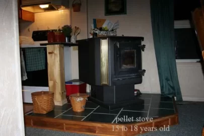

I just can’t nail year down that I bought it, but its close to nineteen years now, with no problems but a blower motor and combustion motor {and you can get better price at your nearest electric motor service} they just don’t make them like they use to!! And I guess I never had the none slide problem so I am no help, sorry
