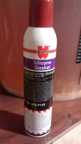

It takes this and 3 hrs! [Hearth.com] Pellets not burning completely Englander PDVC
I was having the same issue for about a month...cleaning everything, tear it apart, blame all kinds of things. Finally I had a breakthrough...I was using a piece of garden hose attached to my vac (which I had tried a few times already) and went up heat exchanger from inside the ash tray hole and found a blockage...really heard the vac bog down. Then I ran the leaf blower trick and cleaned the exhaust blower (dont forget a gasket) and we are back to a sharp flame with no build up! Even blowing more heat now since the exchanger has better air flow.
