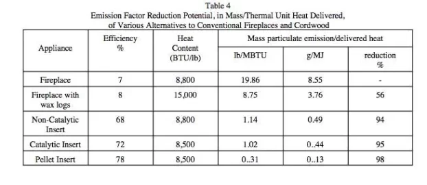

The only material I can find on Pellet Stove efficiency is mostly from our trade group or stuff presented to the government to try to "sell" them on the technology because of air quality, etc.
The only in-home tests appear to the the older Omni series, which shows from 52-68%, the certified heaters being higher and non-certifieds being lower. BUT, these were older generation pellet stoves.
The enclosed chart is what is presented as the average efficiencies in literature from our industry "experts" to the government. Harry will be glad to see that Pellets are showing up a bit higher, but the same report says tests at the lab vary by as much as 20%.
So, give the Pellets their due for less moisture and for 10% greater efficiency.
Unlike oil and gas, Pellet stoves are not tested for AFUE, meaning their actual efficiency over the on/off cyles - low, high and even then not being used (do they radiate cold when rear vented and hooked up to outside air?)
Within the next couple years, we'll probably see another in-home study. That is really the only thing that tells the story.
Yes, very few actual real-life tests, and certainly not enough data to compare one stove with another....all thats prevalent is really lab tests and we all know those are optimum conditions, almost never met in the "real world". And when hooked up to outside air for combustion, they DO NOT radiate cold, at least not now. The distribution air stream is separate from the combustion air stream altogether, and although the manufacturers seem to say you can gain efficiency by using outside air, Ive really never seen it.
