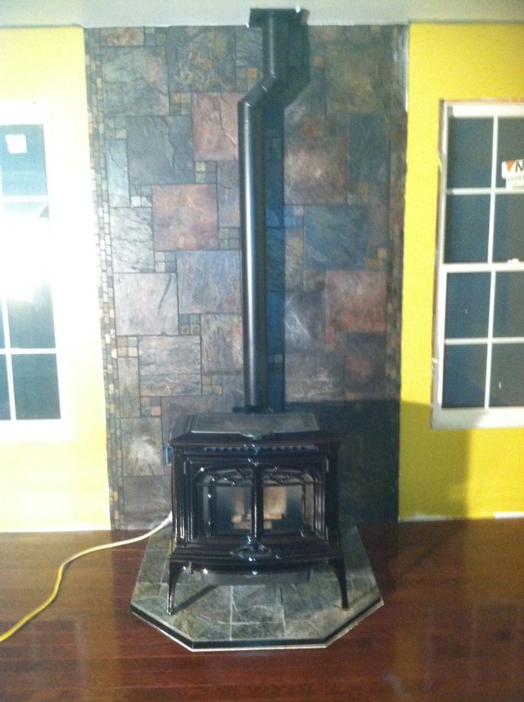

The bump to the right kinda works because the tile work is all up and to the right too. Man, I'll tell you all what...that is a HEAVY stove. We removed about 210 lbs out of it and it was still 200lbs huffing up the stairs.
Used Simpson PVP 4" piping painted with Stove Bright Satin Black #1990 (Actually it was stove pipe touch up #2330). The take-off is to the right and using a T with a 45 into a 45 plus a modified 4" stove adapter we were able to get the pipe aligned to center...but were still off about 5/8 of an inch. It worked out ok cause the rafters overhead made us have to bump out back to the right, it would have looked hokey going straight up from the far right.
The stove is in awesome shape adn for those of you who are contemplating an enamel cast stove...this is the cat's meow...still my favorite stove of all time.

Scott did the install so I have no doubt that everything is up to code. Started grouting the tile, using two part epoxy grout. First time using epoxy grout, kind of a pain in the ass. It does look nice, and supposedly never needs sealing.

Yesterday afternoon I got the OAK installed. Popped off 4 of the 2x2 tiles behind the stove and got her done. Scott was going to do it as part of the install but it was going long so I told him I would take care of it.
So the better half and I stayed up till around 1 AM getting the tile grouted. Obviously would've been easier to do before the install but things just didn't work out that way. The epoxy grout is definitely a PITA to work with, but looks great, and hopefully never needs cleaning/sealing.

So if you look at this "before" grout photo below and compare it to the "after grout" photo, you will notice that all of the tile has a black haze over it. Side effect of using two part epoxy grout at 1 AM and not sufficiently cleaning the tile afterwards. That grout is impermeable, but a major PITA to clean up. Just got back from Home Cheapo with some sulfamic acid to wash the tile and try and remove the haze.

Just got a quote from a flooring guy to install the pre-finished hardwood at $1.20/sq ft. Seems a no-brainer to have a pro do it and know that it is done right. Just have to get it painted first. After that is to tile the hallway into the room and door and window trim. Should be finished soon.
So the room is painted and the flooring guy finished yesterday. Here is a crappy cell phone pic under halogen work lights. The room is not actually that yellow, more of a greenish gold:
[Hearth.com] Pellet Stove Install Advice
Need to do the finish electrical and trim. I think the dark floors look awesome with the brown enamel stove.
There is an ultra-blok surge suppressor on the end of that extension cord. I ran the stove for a couple hours yesterday to take the chill off the upstairs and get more used to how it operates. This baby can really throw the heat when on full blast.
