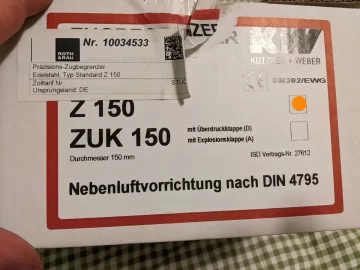

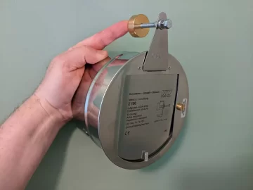

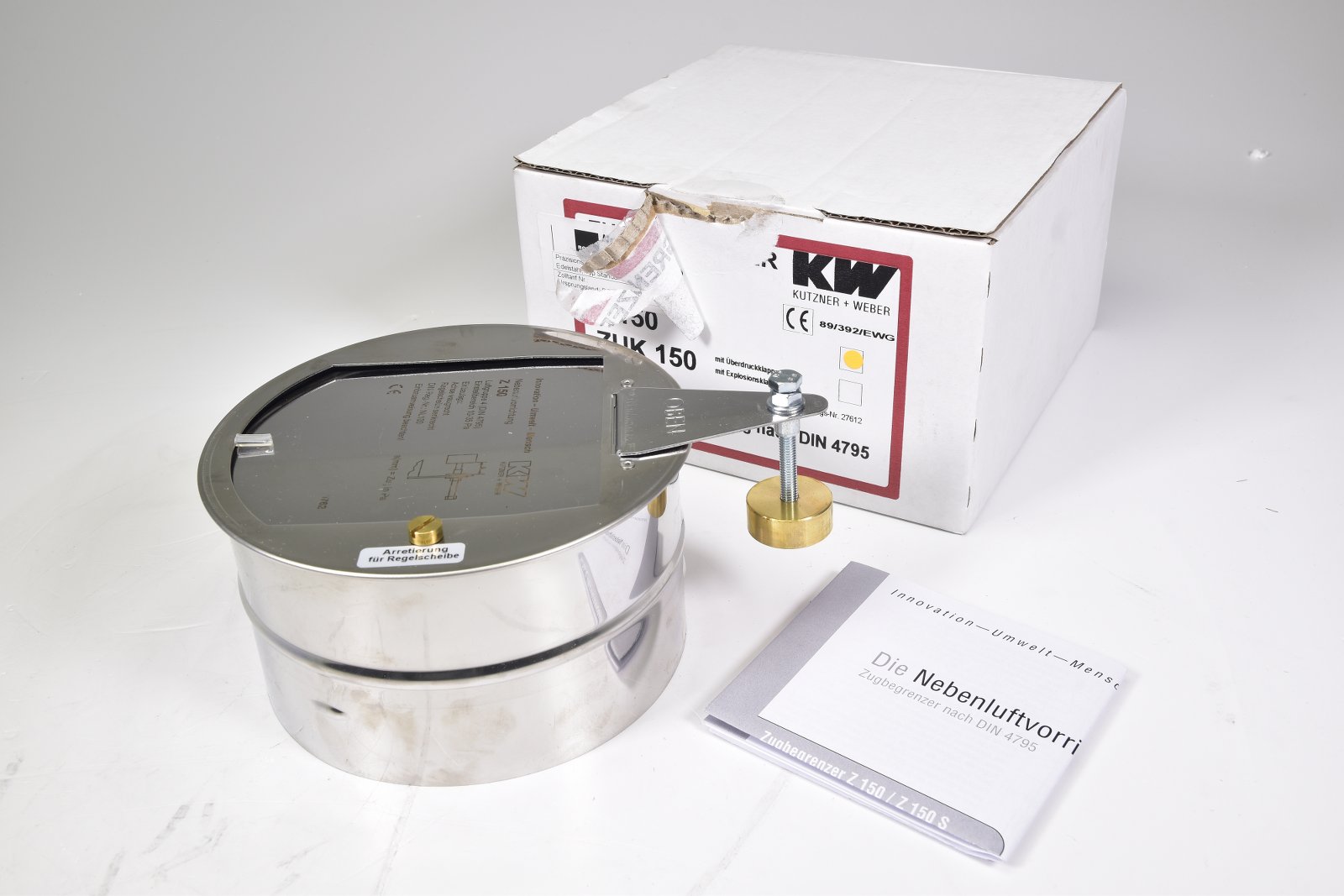

Found a source in Germany, industrial recovery/surplus place, that had them at a good price
(broken link removed to https://www.lagerwerk.com/cn/machinery-parts/parts/21927/kutzner-weber-10034533-z-150-draught-regulator-10-35pa)
Got one. Shipping not as cheap as I wish - but "all in" cost to my door still no worse than what I'd probably pay for a US one that might cause me the dust ejection issues. Arrived rapidly. Elegant design and workmanship and arrived in good condition.
PS, there's a K+W model that is even more deluxe than what I got, with gasketing around the edge of the opening. I am going to hope that this is already so much of an improvement over the usual US type, plus the sophisticated controls of my Windhager, that it will hopefully keep me away from airborne ash

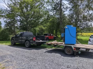

Here is the "goodbye" photo for my old cordwood gasifier, which is going to the new home of a friend & neighbor who is an immense help with a lot of what I am doing. For him, it will replace a non-gasification boiler. This boiler I am saying goodbye to is a circa 2008 Econoburn. There are a variety of ways in which I was pleased with and impressed by it, but also a few distinct frustrations. But any of that is a different discussion than what I want to focus on in this Windhager install thread. Getting all 1800 pounds of Econoburn out of my below grade old house cellar was ... an undertaking, and I was very glad for the skillful help from my friend & neighbor.

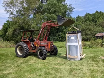

Here is #2 of two 119 gallon tanks, newly sourced for the Winhager install, moving across the yard, to go "down the hatch" - the next photo, separate post, will be of it going down the hatch. Took _A LOT_ of planning but thanks to the great help of the friend & neighbor, and my wonderfully understanding/enthusiastic/adaptable/helpful girlfriend, pulling the Econoburn and getting the two 119 gallon tanks, unscratched, into my below grade cellar, took only about 3.5 hours of concentrated "do it"

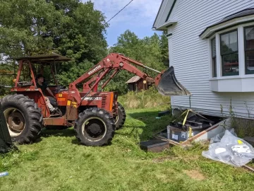

"Down the hatch" onto a waiting pallet jack, of the tank #2 of two, of the 119 gallon tanks. There wasn't much room to to spare in any direction of avoiding something bashing into something pretty severely, but, thanks to sweating a bunch of details in advance and _especially_ some great help from the friend & neighbor, and my girlfriend, there was literally not a scratch on anyone or anything. My house is kind of a relic but thankfully the whole basement has a concrete floor and the area that the Windhager and these two 119 gallon tanks will be installed, also has a poured concrete foundation.
