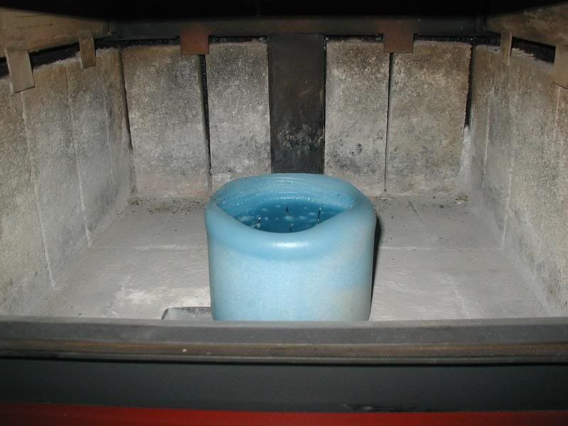

The Secondary burn chamber is totally built of stainless steel and is one floating box at the top of the fire box. http://i9.photobucket.com/albums/a97/Roospike/FOURM/P8250408.jpg http://i9.photobucket.com/albums/a97/Roospike/FOURM/P8250410.jpg http://i9.photobucket.com/albums/a97/Roospike/FOURM/P8250411.jpg Thread link: https://www.hearth.com/talk/threads/2874/
The Summit, if I recall it’s 2 pins and out it comes.
The secondary burn chamber is held with 1 pin/key as seen in the top back opf the fire box
