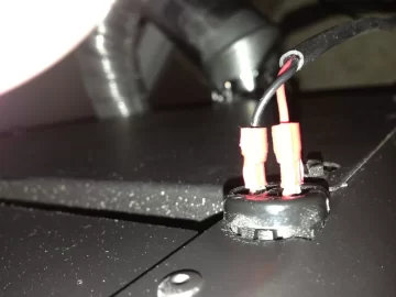

![[Hearth.com] P68 Issues - Any Theories? [Hearth.com] P68 Issues - Any Theories?](https://www.hearth.com/talk/data/attachments/125/125247-775bf59e23186acfe1e58e6e4efa8464.jpg?hash=_6qQGM_AgL)
