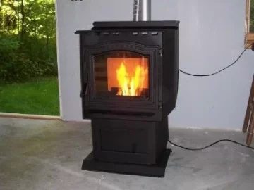

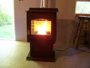

OK since the pic are attached, it must have really happend :-)
The burn in went great and all is well.
I do have my first question. During shutdown, the auger would advance for a few seconds every so often. I assumed this was normal, but it seems odd that the unit would add pellets while shutting down. The dealer stated that it was clearing the auger system of pellets. Being a bottom feed system, I thought that the auger was open to the the hopper. Is there a system that opens to drop pellets into the auger system?

gbreda,
Very nice looking stove and flame! That should really put out some heat. It's still green there........
My XXV keeps dropping pellets into the auger feeder box and augering them into the burn pot for 10 to 15 minutes after shutdown is initiated. I think it's trying to cool the whole thing down slowly. If there are very few pellets in the hopper - you can look down at the slide plate assembly and watch it moving back and forth to drop the pellets into the feeder box, at the front of the auger. That's on the XXV - I don't know if it's the same on the p68. On mine it slides an inch to the right then an inch to the left. It's kind of slow and deliberate. The pellets sound like kibble dropping onto a pie tin.

Congrats on your new stove! Bet you will love it.
Happy Burning
I do have my first question. During shutdown, the auger would advance for a few seconds every so often. I assumed this was normal, but it seems odd that the unit would add pellets while shutting down. The dealer stated that it was clearing the auger system of pellets......
That's an odd system. One would think that for the fire to go out, you would want to stop supplying pellets to the burn pot ASAP. My Astoria stopped the auger as soon as it went to shutdown mode. The pellets stay in the auger, and as soon as the stove turned back on, pellets were supplied immediately.
BTW, yes, we see pics, so it really did happen....Nice! :-)
I think the mechanism is the same, or pretty much the same, on all of the Harman's. My understanding is that the slide-plate is connected to the auger by a cam mechanism, so it can't function independantly; if the auger turns, the plate slides, and pellets drop in. so it couldn't be "clearing" the auger tube of pellets. Plus, when my stove starts up, I see the auger make one turn, and there are pellets right there, being pushed into the pot.
So why it continues to feed after you tell it to shut down, I don't know.
