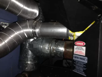

X2, but the Selkirk DT venting makes the ash more lite and fluffy for far less carbon buildup!. That is our secret!
Nice vacuum cleanout for venting too!
See pic below. Click to Enlarge:
  • [Hearth.com] P series Harman users  what's your secret to cheap pellets ?

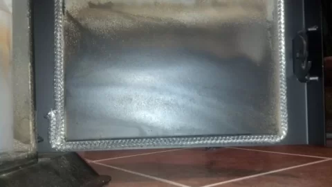

Well, alternativeheat, just gave my stove a quick clean and checked out my ash pan door. Looked like it always has, which is where the problem was. Same thing as yours...lower right hand corner. My tell tale sign of an air leak was about 3" high and 8" wide! I can't believe I've seen that so many times and yet it never registered as an air leak. I'm usually meticulous about making sure everything is in order, yet since day one, the door has been leaking. Humbling, for sure. Definite DUH moment. Aside from the clean spot on the door, it also failed the "lighter" test.
Anyway, rather than replacing the gasket, I simply tapped the lower hinge pivot tab, using a hammer and screwdriver, towards the back of the stove a bit. Did it a tiny bit at a time. After a couple attempts, it passed the lighter test.
I don't think it'll affect the ash output at all, but it's certainly a problem that needed to be addressed.
Thanks for mentioning it ;)

Here's the evil leak.
I cleaned my stove today and I had ash right out to the gasket this time, all the way around the door. Now I have a slight leak above the lower hinge on the upper door. well actually I had it all along, my flame took a dip there some time ago, it hasn't gotten any better !
