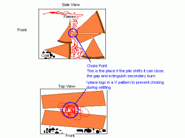

So the routing is, 1 log loads till about 8pm or so, then maybe two splits till 10-10:30 to get the coal bed going. Go out to the garage to get some wood, I'd guess I pull in 50 lbs or so at a time in my plastic tub. Load about stove as much as possible and open the air all the way for about 10 minutes...then DAMPER DOWN..he he...o.k. shut the air control all the way down. Now watch the nice deep blue and orange flames do their magic dance.
Loading the wood side/side will have it last longer than loading front/back. F/b gives you good fast hot burns & quick start-ups because the air coming down your glass zips through the wood easily, and you get some quick hot flames. With the logs loaded s/s the air coming down your glass hits a wall of wood, and can't flow so easily to feed the fire slowing down the burn.
Most of what I say from here on applies to side/side loading, it's what I do and what I know. Try to put the wood as far away from the glass as possible. The closer it is to the glass the faster it burns because the air wash is blowing on it, and keeping it away your glass stays cleaner. Also it extends the distance the hot gases must take to get out increasing the amount of time & contact with the secondary burn. I've found logs stacked high and near the glass, they burn quick and the flames coming off them loop right around the front and out it goes having minimal secondary burn contact and very little distance for the heat to transfer. It's probably more with big units, but I can fit 6 log splits (3 stacked up in back + 3 front) I'm better off using 3 splits in the back and 2 in the front. It doesn't affect my overnight burn time nor seems to affect the amount of heat I get very much, that tells me most of the heat from the top front log wastes out the flue like I think, so I skip it.
Your fire burns through the front first, and then works it's way back. If you want hot embers in the morning, place your big splits in the back and you'll have to experiment with placement/positioning. If I have a piece of wood flush against the back wall, by morning it will be a monstrous piece of extinguished black charcoal and not burning. I either have to pull it away from the back wall when loading, or better I place it bark on the floor so it points up and leaves space behind.
When lighting a fire, I think it's best to get a kindling fire going and then load her up completely afterward. You want secondary burn as fast as possible and starting a kindling fire, and adding a couple logs, and then after they're going add a few more slows the process. I start a pile of kindling in the center and when it seems to be taking I shut the door. It dies down a little and struggles, even sometimes goes out and I have to relight (hence why I don't load wood yet), eventually draft establishes, it recovers, and turns into a good flame. That's my signal to load my wood, all of it behind & in front of my kindling fire, leaving plenty of space between. Flames will be reaching up and over the secondary burn. Once the flames are reaching around the top front, I turn down the air.
You'll have to experiment with your air settings, the lowest setting may not be appropriate. I've turned mine down as low as possible and my fire smoulders and throws smoke out the chimney. The lowest air setting for me and not have smoke spewing out the entire time is about 25%.
I included a picture of how I set my wood up for an overnight burn, I load side/side, burn just about strictly red oak, 21" log lengths. I'm also not going to say I get overnight burns each time, about twice a month there won't be a hot ember to be found anywhere when I get up, and about as frequent I'll come down to still see a flame and huge amounts of hot embers. Probably environmental/atmospheric conditions at play.
